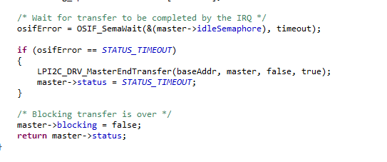

yeah , it reaches the LPI2C_DRV_MasterIRQHandler functionj , the program reaches the  osifError = OSIF_SemaWait(&(master->idleSemaphore), timeout);
I understand that it is a problem with the release of the semaphore , have integrated the free Rtos in the current project , so could you please let know what are the main changes to be taken care when using the free RTOS.

Please call LPI2C_DRV_MasterGetTransferStatus after the blocking transfer and let me know what is the status returned by this function. Based on your logic analyzer capture I suppose the timeout is too small and timeout event occurs.

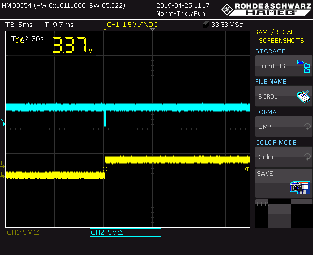

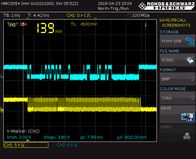

It seems that the SCL remains low at the end for both cases. The only difference is that you are sending just one byte
calling LPI2C_DRV_MasterSendDataBlocking(INST_LPI2C1,buffer,1,false,1);
The SCL might be held low by the slave. To check this, you could try disconnect the slave and then look at the SCL signal(if the signal is still low then the problems are caused by the master).
Do you observe any difference if you use generate stop at the end instead of repeated start: LPI2C_DRV_MasterSendDataBlocking(INST_LPI2C1,buffer,TRANSFER_SIZE,true,0xFFFF)?

There is no change with the usage of generate stop , I had one observation ,  the clock is released (HIGH) once I suspend or stop the debug .
When the program is suspended the PC points to the Default ISR as can be seen in the snapshot.

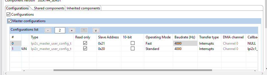

We currently make use of the external pull up resistor , the callback function extern void lpi2c1_MasterCallback1(uint8_t instance,lpi2c_master_event_t masterEvent,void *userData); is defined as dummy NULL function.
