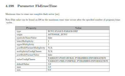

After looking into the User Manuals, I can see this parameter was last implemented in the RTD 2.0.0:
These were removed with the implementation of RTD 3.0.0. They are no longer relevant for current C40 implementation.

1. Based on your response, I understand that the current S32DS+RTD combination cannot be configured using the "Mem Erase Time" and "Mem Write Time" options.

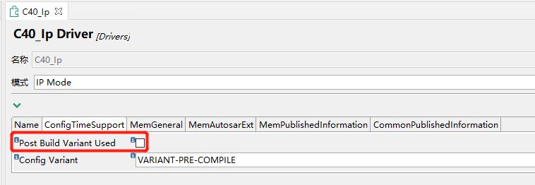

3. Regarding the "Post Build Variant Used" configuration option that I mentioned earlier, there doesn't seem to be any change in the generated code.
Could you please explain how it is supposed to be effective and configured?

1. Yes, this is correct. The latest version for Design Studio and RTD packages do not include these parameters for the module.
2. Yes, since these parameters are no longer available for configuration. You can use them in your project if your RTD packages support them, and as I've shared in the previous, these parameters describe the maximum time for the operations.
3. The PRE-COMPILE and POST-BUILD variants both function as an AUTOSAR specific option.
If you configured Config Variant as PRE-COMPILE, you won't need to add a parameter for the initialization function in the main code (e.g Eth_Init(NULL)).
If configured as POST-BUILD, then it is necessary to add the pointer to your configuration type name as parameter (e.g Eth_Init(&Eth_Config_BOARD_INITPERIPHERALS))
In PRE-COMPILE, technically it will auto find the config in your module (normally, will be predefined for the name) and start the Init process. In POST-BUILD, Init function will find the config name which is given by Parameter in post-build time. In post-build, you can use the functional groups mentioned in the community post I've shared.
This is why it is not reflected directly at the code, as there is no code change necessary for this configuration, the only change visible will be at the .mex file.

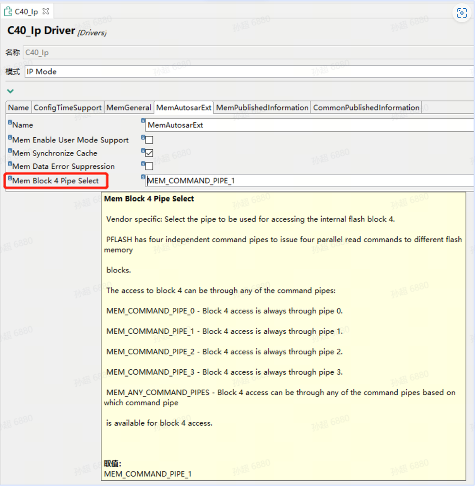

1. Regarding your previous response to the second question, if the S32DS+RTD version I am using does not support a specific configuration parameter, but I still want to use this parameter without switching to a different version, do I need to manually modify parts of the RTD to implement it?
2.Is the "Mem Block 4 Pip Select" configuration also no longer supported?

Julián_AragónM
Hi @Chris-Sun,
1. Functionality of the specific configuration parameter is not guaranteed for outdated RTD values in different versions. If the value exists in the drivers, it can be modified manually.
2. Mem Block 4 Pipe Select selects the pipe to be used for accessing the internal flash block 4. PFLASH has four independent command pipes to issue four parallel read commands to different flash memory blocks. The access to block 4 can be through any of the command pipes: MEM_COMMAND_PIPE_0/1/2/3 or MEM_ANY_COMMAND_PIPES.
This value is still supported for the current drivers.

Regarding your previous response:

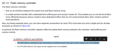

Is the configuration item "Mem Block 4 Pipe Select" only applicable to S32K3x8 and S32K3x4?

Julián_AragónM
Hi @Chris-Sun,
Chapter 22.1.2 Flash memory controller describes which blocks are not present in which derivatives of the MCU.
Julián.
