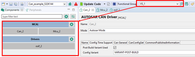

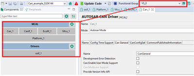

  2. S32Configuration Tools > Peripherals/Pins/Clocks

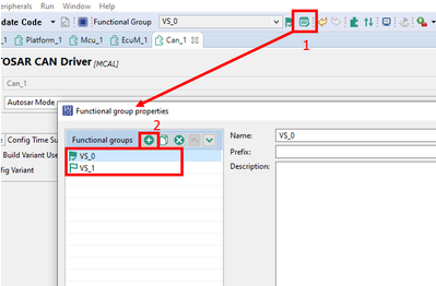

    From here you can add more than 1 configure in Functional groups:
  3. For each functional configure, you can configure it as you want:
    Remember to choose Config Variant as VARIANT-POST-BUILD
  1. Click on Update Code button

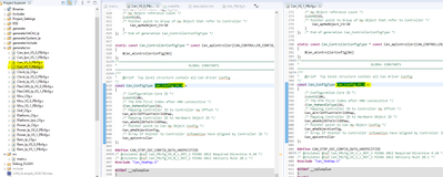

  2. After update code, you will have more than 1 configure of CAN config:
  1. You can use one of these config in you main application by Can_Init:
Can_Init(&Can_Config_VS_0);
OR  Can_Init(&Can_Config_VS_1);

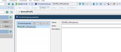

@cuongnguyenphu I just tried to test it but I don't know why, I can't add a new groups, it's disabled

BeCy
Hi @cuongnguyenphu !
I think I'm already on the last version of S32DS :
I'm using S32K144W.
