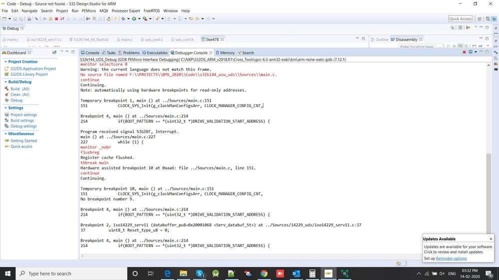

I fallowed your suggestion even though the error is coming. i think some signal intterupt is coming so it is giving error like
Program received signal SIGINT, Interrupt.
0x0000e478 in ?? ()
After debugging in debugger console view it showing error like No source available for the application project main() file.
How can i resolve this issue?
I attached debugger console window for better information.debugger_console_view.jpg

Ray_V
Contributor V
I also noticed in your entry from Feb 13, 2020 3:18 AM
You tried to issue the command
file F:/PROJECTS/BMS_2020/Code/s32k144_asw_uds/Debug/s32k144_asw_uds.elf
this command replaces all symbols instead of adding. I also noticed that you have some errors
Reading symbols from F:/PROJECTS/BMS_2020/Code/s32k144_asw_uds/Debug/s32k144_asw_uds.elf...done.
Error in re-setting breakpoint 3: No source file named F:\\PROJECTS\\BMS_2020\\Code\\S32k144_UDS\\Sources\\main.c.
Error in re-setting breakpoint 4: No source file named F:\\PROJECTS\\BMS_2020\\Code\\S32k144_UDS\\Sources\\14229_uds\\iso14229_serv11.c
From this it seems that you compiled your project in one directory
and then moved your project to a different directory
The information is saved with the complete path, so the debugger can't find the sources.
If you move your project you need to clean and re-compile so the debug source paths are correct

Ray_V
Contributor V
The SIGINT is normal with some breakpoints, I don't think it is a problem.
About the "No Source Available" message, on the debugger console enter
add-symbol-file "F:/PROJECTS/BMS_2020/Code/s32k144_asw_uds/Debug/s32k144_asw_uds.elf" 0x0x0000E000
After this is done you can single-step and it should refresh the debugger to show the code.
You can even issue the add-symbol-file before jumping to the program so it will show the source right away after jumping

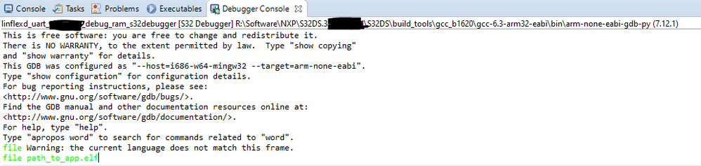

raresvasile
i wanted to jump from bootloader to application, but i am facing error like
No source available for "0xe478"
This error appears because gdb does not have the debug symbols for the application. A workaround can be done by adding a breakpoint to the entry of the application and by manually loading the debug symbols in gdb.
In S32DS, Debugger Console view, type file <path_to_app.elf> and after the next step the symbols will be loaded.
As far of the entry of the application: If you are running in thumb mode, then you must add 1 to the entry address to let the cpu know that the code is in Thumb.
/* Add 1 to the entry to respect Thumb requirements */
__asm("add r1, r1, #0x1");
/* Jump to application PC (r1) */
__asm("bx r1");
Hope this helps.
