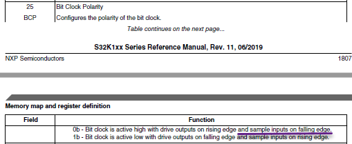

When I configure SAI0 transmitter with bitclock active LOW, it works fine. SAI0 transmits data on falling edge of bitclock (is this right?).
When I configure SAI0 transmitter with bitclock active HIGH, it does not start to transmit at all. Should it work with the attached signals? If not, what should be changed?

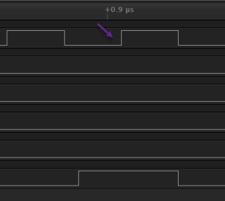

Please find attached SAI0 register dumps for bitclock active low and high respectively. Attaching also signal traces for both cases, zoomed in and out.
Channel 0 : bitclock
Channel 1-4 : data
Channel 5 : frame sync
Jakub

I used your slave configuration and emulated the master using a PWM signal and a GPIO - to keep it simple - based on the captured signals you sent.
I'm able to reproduce this behavior because the frame sync in your application can be sampled on the rising edge of BCLK
which is correct when BCP = 1.
When BCP = 0, the frame sync signal is being sampled on the falling edge of BCLK as shown below.

I meant that the slave can't see the FS because the FS is just one BCLK period long and can be sampled on the rising edge of BCLK only. Can you reconfigure the master to send the FS signal on the rising edge of BCLK so that the slave can sample the signal on the falling edge of BCLK.
