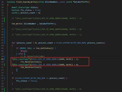

Issue: Fls_MainFunction execute is too long runtime
1,153件の閲覧回数
DennyZhang
hi, nxp developer!

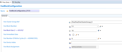

  I use the fee&fls to emualate the eeprom.  i config 16Byte block in fee.
  when i execute Fee_Write to write 18 blocks, and then call Fls_MainFunction  and Fee_Mainfunction.
  Each block write, call Fls_MainFunction execution, close to 1ms.  18 loops, execute too long.
  Question 1: i use the RTD1.0.0, is the version of the flash erasing time? if RTD version cause,  how can i optimizing the problem in RTD1.0.0?
  Question 2: Could a misconfiguration of fee or fls have caused this problem? I've enabled the cache. What other configurations can be used to reduce execution time?

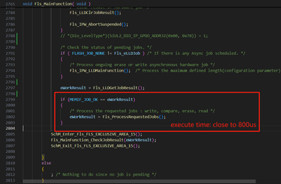

debug the FLS_Mainfunction, i find the time-consuming function.
