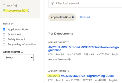

Dear Sonthaikhac,
this is very well described in the sections 6.3 Recommendations for SYS_CFG1 and SYS_CFG2 registers and 8 Cell balancing in an AN12084 MC33771B/MC33772B programming guide.
Please download the AN12084 from the MC33772C product page, under the secure files.
Please also refer to the AN12637.
