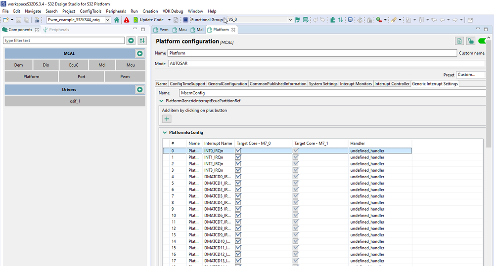

jiri_kral
I'm not much familiar with the RTD and S32K3xx - but it looks, that there is not properly setup the platform package - if you like to handle some IRQ only by core 1, you need to uncheck core 0 (image is only for reference, the project is only single core - in your case the Core 1 column should be available for editing):
Jiri
2,837 Views
winsmen
@jiri_kral I did uncheck core0 and set only core1 as the target of the interrupts I would like to be serviced only on core1, but with this configuration the ISRs never get called. However, I do see the flags from the peripherals which are meant to trigger the ISRs being set.
