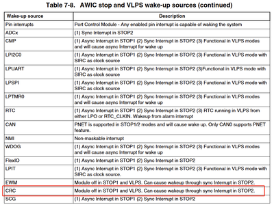

How to use CRC to wake up S32K144 in the STOP2 mode?
970件の閲覧回数
PYGC
I can't find the CRC interrupt and interrupt vector number.
959件の閲覧回数
danielmartynek
Hello @PYGC,
The CRC module does not have an interrupt.
Thank you for pointing it out, it has been reported.
BR, Daniel
