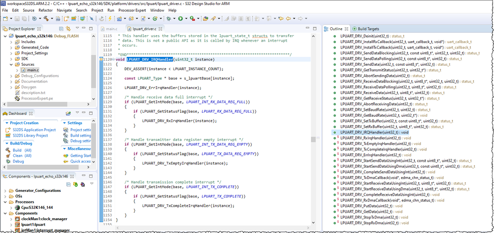

Your LPUART0_RxTx_IRQHandler looks similar to LPUART_DRV_IRQHandler in SDK. Please check lpuart_echo_s32k146 example in SDK, will the glitch cause this phenomenon too?(I don't know which S32DS are you using. Here is the link of latest SDK RTM4.0.2)
2. Did you enable all those listed interrupt of Flag in LPUART Control Register (CTRL)? Can you disable some of them so you can easily filter out which flag caused it?
