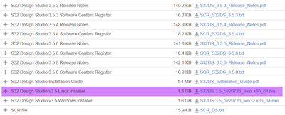

I am trying to install development  pack in Ubuntu system. Installation module is not included in the downloaded software. Please help me.
Kanakaraju
1 回复
2,942 次查看
VaneB
Hi @Kapila
The .zip files are for Windows OS, and Linux OS is needed to download a .bin, as shown in the below image.
Also, I am attaching an installation guide that might be useful for you.
