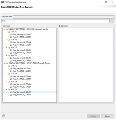

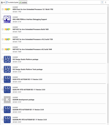

5,898件の閲覧回数
cranes
Hello PetrS,
This is what I see in my folder after installing SW32K396_S32DS_3.5.1_D2207.zip:
In the PlatformSDK_S32K3 folder, only RTD, there is no stack folder.
These are what's installed:
When creating the project from the example, only RTD, no TCP/IP stack.
Anything might be missed in my installation?
Crane

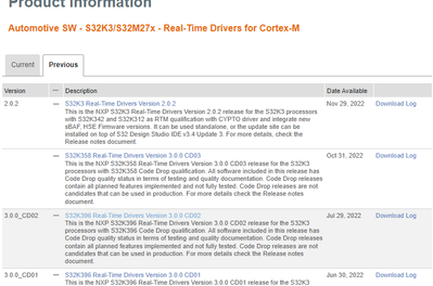

5,771件の閲覧回数
jiri_kral
the FreeRTOS for S32K396 requires particular version of RTD. Based on FreeRTOS for S32K396 release notes the required RTD version is Code Drop 02 and S32K396 dev package EAR2:
With this configuration you should be able install FreeRTOS package.

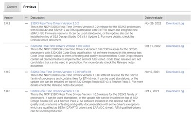

5,758件の閲覧回数
PetrS
try to check "Previous" tab as well
BR, Petr
5,752件の閲覧回数
cranes
This is really weird. This is what I see in the previous tab:
Thanks!
