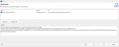

I am trying to install TCP/IP stack for S32K3 by following below steps. In S32 Design Studio,
Help->Install New Software->Added the package SW32K3_TCPIP_STACK_1_0_4_D2401_DS_updatesite.zip which was downloaded from NXP website.
But I am facing below error during installation.
How to resolve this one?

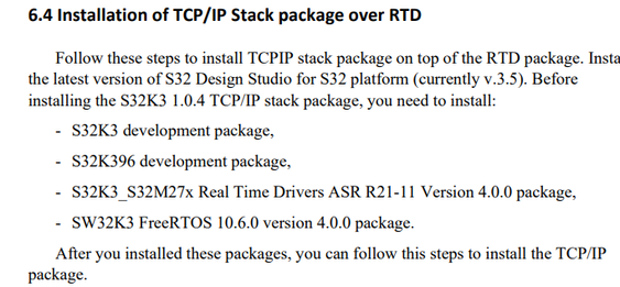

please refer to the release note
Before installing stack, you need to install some other dependency packages.
