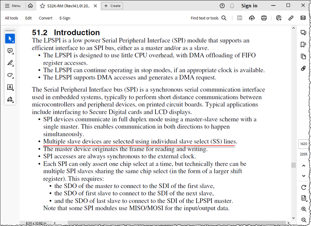

Do you want to select a different salve via SPI0_CSx? Yes, you can select different slaves through SPI0_CS0~SPI0_CS3.
Multiple slave devices are selected using individual slave select (SS) lines.pngMultiple slave devices are selected using individual slave select (SS) lines.png
