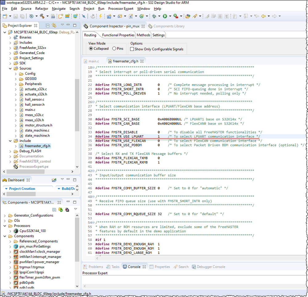

A3. When you debug for the first time, you have downloaded the program into S32K144. This project is set to connect to FreeMASTER (MCAT) through UART, so you can connect to MCAT after powering on again.
