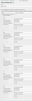

  • I have done my best to configure FlexIO, DMA, and DMA Mux per the RTD_I2C_UM, using only the low-level drivers.
  • I have verified that MC_ME is enabling the TCD clock registers during Clock_Ip_Init (and PRTN1_COFB0_STAT = 0xffffffff after Clock_Ip_Init())
  • DmaInit is able to execute hwv3AccInlineDmaCh_CmdClearDone successfully for all the DMA channels in use

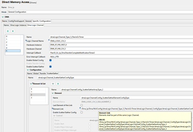

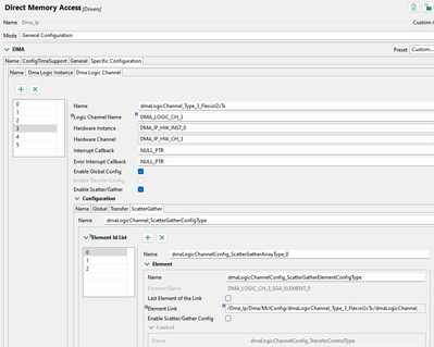

FlexIO I2C is configured with "I2c DMA Used" and "I2c DMA Optimize Mode"
DMA is configured with 3 channels (Tx, Rx, Timer), each with Global Config enabled at default values, and Tx and Timer configure with 3 and 4 Scatter/Gather lists each:
Tx element 0 (dmaLogicChannelConfig_ScatterGatherArrayType_0) element link = /Dma_Ip/Dma/MclConfig/dmaLogicChannel_Type_3_FlexioI2cTx/dmaLogicChannel_ConfigType/dmaLogicChannel_ScatterGatherConfigType/dmaLogicChannelConfig_ScatterGatherArrayType_1
Tx element 1 (dmaLogicChannelConfig_ScatterGatherArrayType_1) element link = /Dma_Ip/Dma/MclConfig/dmaLogicChannel_Type_3_FlexioI2cTx/dmaLogicChannel_ConfigType/dmaLogicChannel_ScatterGatherConfigType/dmaLogicChannelConfig_ScatterGatherArrayType_2
(and so on, similarly for Timer)
Rx only has a single Scatter/Gather element (though perhaps none is needed?)

Looks like the hard fault was due to the lack of "Enable User Mode Support" in the DMA module.
I also realized that Flexio for SCL and SDA each need a "Add Channel" configured. Now I'm able to see SCL toggle for a DMA transfer, but nothing on SDA.

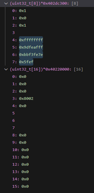

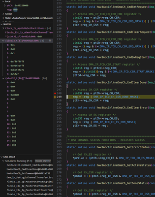

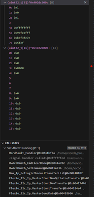

nehalp
Before Clock_Ip_Init() - MC_ME and TCD[4] registers:
Immediately after stepping over Clock_Ip_Init(). You can see MC_ME has clocks enabled, and TCD is now readable:
Successfully writing to TCD during DmaInit():
Successful read during MasterSendData:
HardFault:
