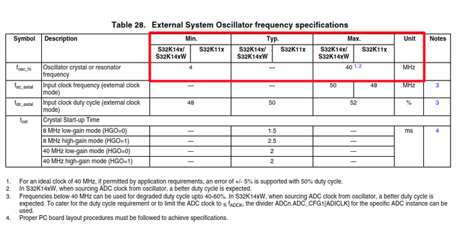

Hi NXP community,
Kindly i would like to ask if its possible to use external oscillator for our clock. The example clock in NXP evaluation board is 8Mhz OSC.
we included 25Mhz OSC in our custom Hardware design, is it possible?

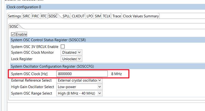

can we change the frequency in processor expert in the "clock Sources" ?
Thank you!

Hi, yes, it can use different oscillator.
And yes, you can change it in Processor Expert:
