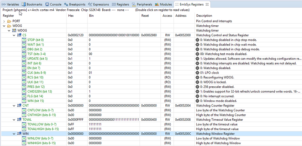

The device hangs on while (((WDOG->CS & WDOG_CS_RCS_MASK) >> WDOG_CS_RCS_SHIFT) == 0U);  near the bottom of the function. It appears that the RCS bit never gets set and this seems to happen because the device is still locked.  However the check above should ensure that the device is unlocked before trying to write to the watchdog control and status (CS) register. Below is a capture of the watchdog registers when the device hangs.
S32DS debugger when device hangs.
This does not happen consistently and I cannot reproduce this problem on demand.  When this problem does occur power cycling the MCU and starting a fresh debug session clears the problem.

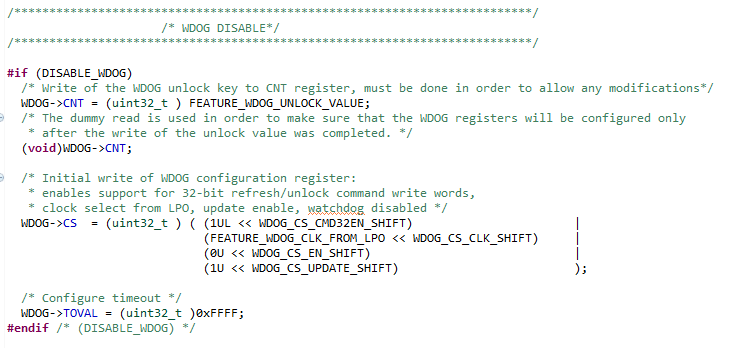

danielmartynek
Hello Stephan,
I'm unable to reproduce this behavior with your code.
Could you send a test project?
Nevertheless, the default S32K1xx startup code in S32 Design Studio disables the WDOG.
SystemInit() funtion, system_S32K148.c.
This code is enough to disable the WDOG and allow subsequent updates in main().
3,693件の閲覧回数
stephandewit1
I now see that my watchdog disable function is unnecessary if DISABLE_WDOG is defined, that is good to know.  This also explains why the watchdog control and status (CS) register did not have its reset value loaded when I was setting the register, it had already been changed earlier in the SystemInit() function.

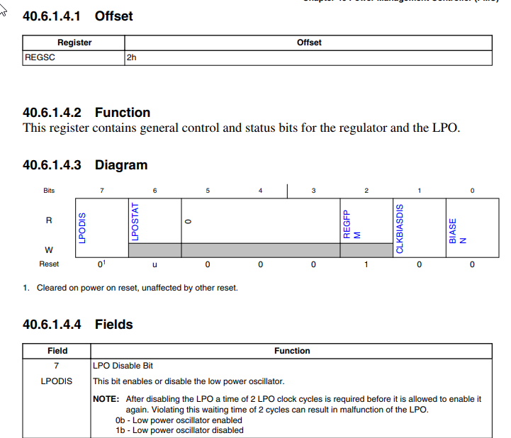

The problems I was having configuring the watchdog are related to its clock source being disabled in a different part of the code.  This LPO disable is not cleared by a reset.
To save power consumption when sleeping the Low Power Oscillator (LPO) is disabled just before sleeping (or Very Low Power Stop (VLPS)) and enabled during wake-up.  The watchdog is clocked by the LPO.  However there was an error in how the LPO was enabled leaving the it permanently disabled after the first sleep cycle.
As per the reference manual below the Power Management Controller (PMC) LPO disable (LPODIS) is *only* cleared on a power on reset (see note 1. below).  This left the watchdog disabled between resets, even resets from the debugger.  This explains why power on resets were the only way to resolve the problem.
From Reference Manual Power Management Controller (PMC)
Another take away from this self made bug is that enabling the watchdog and waiting for its Reconfiguration Success (RCS) bit will not work when the watchdog clock has been disabled.  Makes sense but was not obvious at first.
