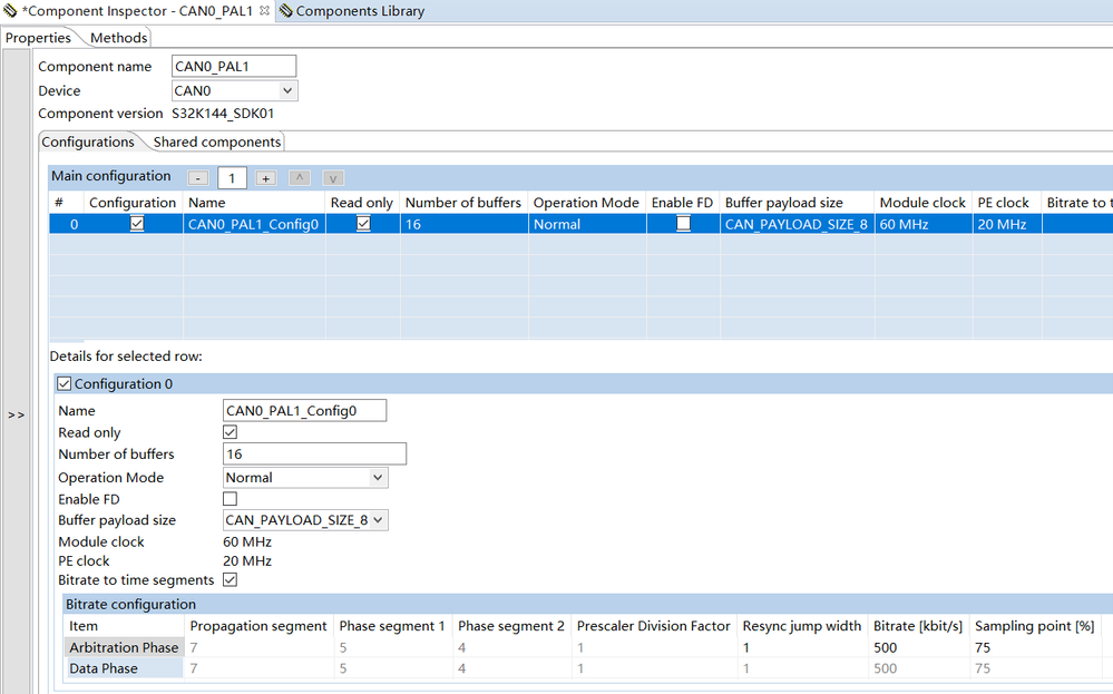

S32DS ARM_2018R1 for S32K, the P/E tool can't config the CAN to RX FIFO DMA mode, how can I using NXP SDK to receive data by DMA?
1,690 Views
razva_tilimpea
DMA mode is not supported in CAN_PAL which is designed as a generic API for all platforms supported by SDK.
If you need to configure DMA or other FlexCAN specifi features please replace CAN_PAL component by FlexCAN component.
