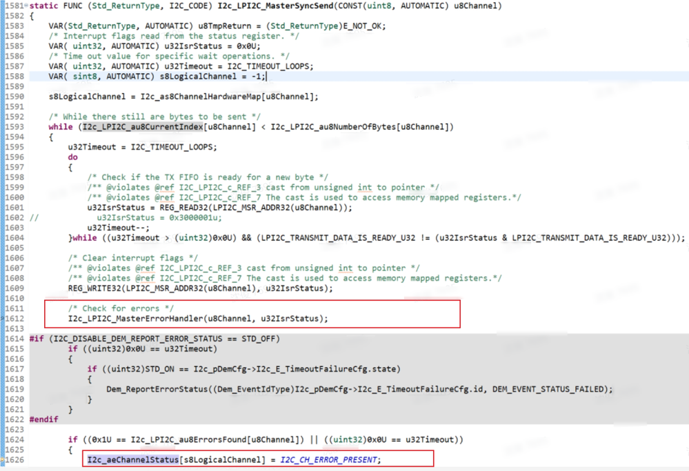

DELPHI_Eric
master sync sendmaster sync send
 I2c master sync send error, 100K
  • It can be transmitted normally through oscilloscope observation the slave device address send out OK
  • but no slave device response ACK, so it ran at
    I2c_aeChannelStatus[s8LogicalChannel] = I2C_CH_ERROR_PRESENT; return NO_OK
    How can I test the master sync send use S32K14x MCAL.
