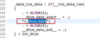

In "libAvas.c" file, here are 3 huge arrays, seems they were allocated at section DTCM:

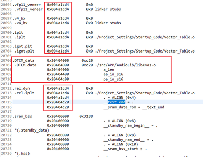

However, there is no ".DTCM_data" section in linker file. Then the compiled result showed a wrong section was inserted in ".text" section, this accident may affect the code execution:
The wrong operation allocated the arrays into SRAM instead of DTCM, which deviate from customer's original intention. We still have no idea about why there is no issue/warning reported by GCC compiler, however, glad that we have found it finally!
Therefore, please kindly modified the attribute section name to the correct name, which can be found in linker file:

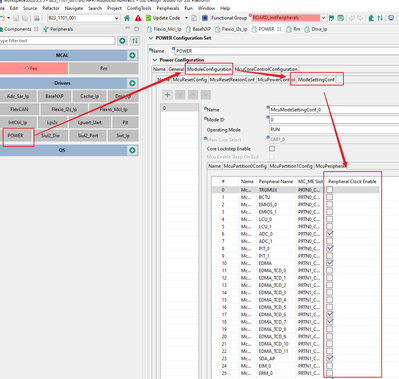

Another potential problem would be the "Power" component configuration in .mex file, in Which the MCU peripheral gate clock was not enabled totally. If customer trying to operate the non-gate clock enabled peripherals, it will generate a bus error, and then jump into hardfault:
Therefore, please kindly check the peripherals will be used, and check the corresponding peripheral clock enabled.
