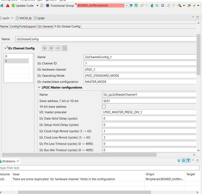

We are using S32K322 Controller and the RTD version is 3.0.0.
We have an external EEPROM & an RTC, both connected in the same I2C Instance (LPI2C1 - PTC6,PTC7).
Here the question is how to configure these slaves addresses separately?
Here I've configured the address and other things for EEPROM at instance 1(LPI2C1), then don't know how to configure parameters for RTC at same instance(LPI2C1).
Because if I try like the method below some error is coming,
