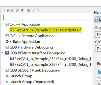

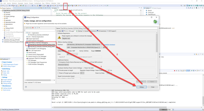

1. After the project build, I always have to do the settings of debug configurations for using GDB PEMicro Debugger. Otherwise, if I directly choose the option "debug" then it selects the .elf file from default setup highlighted below:
Is there any option to make the PEMicro debugger as default choice?

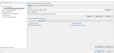

2. How can I run the program without selecting the debug option? My "run as" window looks like this -

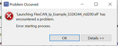

If I select run, this message appears -

Hi@kolyanimohanto
1.In fact, after you configure GDB PEMicro Interface Debugging for the first time, the next time you just need to click the "bug" icon on the picture to enter the debugging
