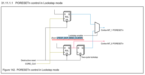

You need to simply switch the device into lock step mode via DCM records.

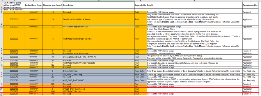

In S32K3xx_DCF_clent excel sheet attached to the reference manual you can see the

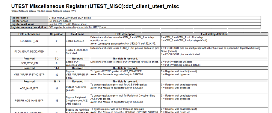

All you need to do is to program DCF client UTEST_MISC to UTEST memory with bit LOCKSTEP_EN set to 1.
For details please refer to reference manual : 21.3 UTest NVM sector
You will do the write to DCF user space area of UTEST:

An example code using C40 IP driver to write in UTEST memory, please find it in the attachment.
It writes 8 bytes with 0xAA in a free location after 0x1B001B00 address.
So change the code accordingly to write lockstep_en in UTEST_Misc on first free location in DCF user space.
Please be sure MPU is not protecting UTEST memory in your code.
Peter

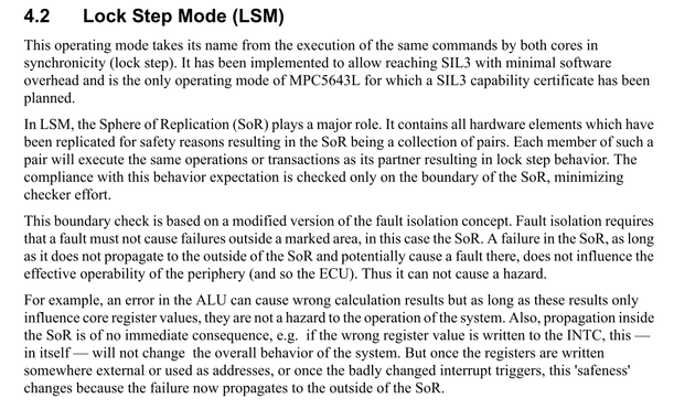

I see that the lock core of the S32K344 is enabled.
As far as I know, both cores run the same program to keep them safe after the lockstep core is enabled.
I need to verify. What do I need to do
6,314件の閲覧回数
petervlna

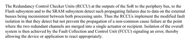

I do not understand. What do you need to verify? It is HW feature and once the Lockstep is enabled is in active all the time.
If there is and issue in redundancy the FCCU will report fault.
There is nothing you can verify. No user access to checker core is possible. there is just no interface.
