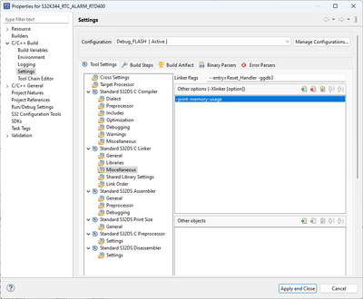

Hey everyone, I am using s32DS for s32 platform and I would like to view the memory allocation of my project. I would like to know the memory allocated to objects and where have they been allocated like SRAM or ROM etc. However , I cant find such a viewer in S32DS, I have seen similar viewer in CCS. Can anyone help me with this?

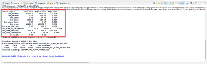

Hi @ssattva1,
You can use the "-print-memory-usage" option to enable the memory usage for each section:
Unfortunately, S32DS does not support the printout for individual file sizes, but you can use the map file to map each section. You can refer to the workaround John Russo shared in the following post: get memory size of each individual file using compiler flags in s32 design studio ide - NXP Communit....
