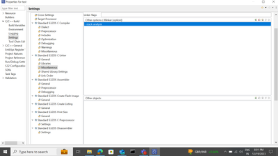

Hello, I need memory usage of seperate .c source files of my project, is there any compiler or linker setting where i can provide the flag in s32 design studio ide, that will print memory usage of each file in output after building the project?
I used this flag but its providing me full memory usage of individual section, but i want the memory usage of each .c file individually

sanjay645
But I am getting error after building the code:
/usr/bin/make --no-print-directory main-build
Building target: test.elf
Invoking: Standard S32DS C Linker
arm-none-eabi-gcc -o "test.elf" "@test.args"
c:/nxp/s32ds.3.4/s32ds/build_tools/gcc_v10.2/gcc-10.2-arm32-eabi/bin/../lib/gcc/arm-none-eabi/10.2.0/../../../../arm-none-eabi/bin/real-ld.exe: unrecognized option '--stack-analysis'
c:/nxp/s32ds.3.4/s32ds/build_tools/gcc_v10.2/gcc-10.2-arm32-eabi/bin/../lib/gcc/arm-none-eabi/10.2.0/../../../../arm-none-eabi/bin/real-ld.exe: use the --help option for usage information
collect2.exe: error: ld returned 1 exit status
make[1]: *** [makefile:47: test.elf] Error 1
make: *** [makefile:38: all] Error 2
"make -j8 all" terminated with exit code 2. Build might be incomplete.

Daniel-Aguirre
We understand that the flag that was used is not the previously mentioned, is this correct? Were you able to use the --stats flag?
We can also recommend using the --help command, since it should provide the available commands.
