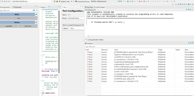

cranes
Hi VaneB,
Here is what's installed in my S32DS:
The errors are like this:
These are the components added without configuring anything.

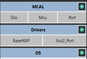

After adding the components of Dio and Ecu without configuring anything, the errors stay the same.
After removing Siul2_Port in Drivers, the errors keep the same.

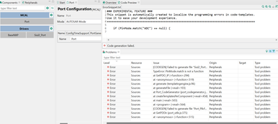

I didn't uninstall the old one as I still need to use it for other projects. I installed a brand new version S32DS at C:/NXP/S32DS.3.5_b (The original one is at C:/NXP/S32DS.3.5). The installed packages are like this:
Then create a new application project. This time, there is no "OS" in the components. But still get the same errors after adding "Port".
Any idea about what else might be missing?

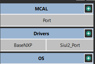

This is how I generate the project:
1. Create a new S32DS application project
2. set project name and MCU
3. configure the project
4. open the .mex file and disable the Pin configuration tool
5. open the peripheral tool and click "+" next to MCAL and choose "Port" in the pop-up window
6. click "OK" and then I see this
In step 3, I tried choose "No IO" for "IO support" as well. And the result is the same.
