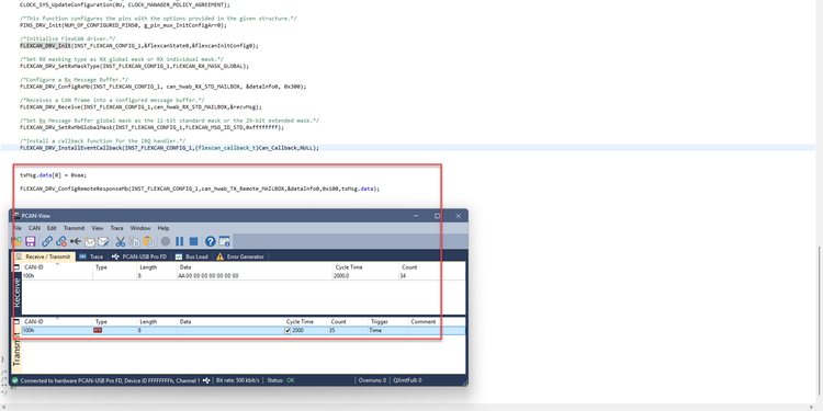

I made a demo for your reference, the RRS is set to 1, and will send ID 0x100 frame back if received remote frame with ID 0x105.

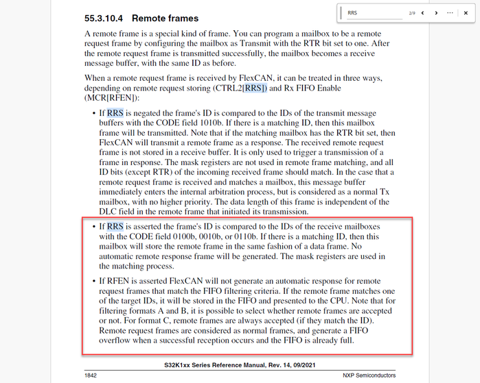

So if RRS is set to 1, the highlight explained very clear, it will be treated like data frames but will no automatic generate remote response frames.

RRS bit is set to 0 default, so you can just use this api:
"FLEXCAN_DRV_ConfigRemoteResponseMb(instance, mb_idx, &txMsg);"
If you want to set RRS to 1, then just receive it like normal data frames.

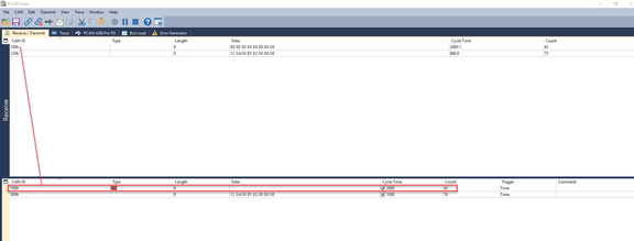

I want to set the global mask RTR bit and IDE to receive remote frames. However, I found that using your configuration is not able to receive them.
Then, after I configured RTR=1 in the MB, I was able to only receive remote frames.
Due to the incomplete configuration of the library functions in the SDK for MB and global mask, in reality your example only performs the corresponding logical judgment based on the ID.
As shown in the figure, I used your DEMO. In fact, for both data frames and remote frames, as long as the ID is 0x105, they will be received. I think this is not very rigorous.
