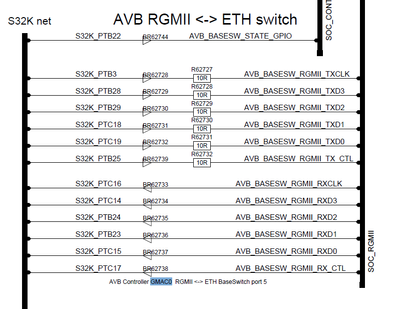

Hi Everyone,
I am working on an S32K328 MCU and trying to establish Ethernet communication using a MAC-to-MAC connection. In my setup, the S32K328 GMAC is connected via RGMII interface to a switch MAC, and the switch is further connected to a PHY.
I am able to see that the link status is up, but no Tx or Rx traffic is observed. I suspect this could be related to clock configuration, but I am not sure what needs to be verified.
Could you please clarify the basic requirements for a MAC-to-MAC connection and provide details on:
  1. Clock configuration and source requirements for RGMII in MAC-to-MAC mode.
  2. Any specific GMAC register configurations or settings needed for this setup.
  3. Whether any RGMII delay or skew adjustments are required on the S32K328 side.

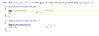

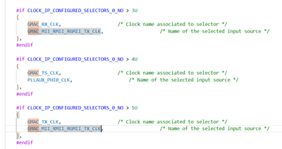

sathishkumar_sunmugavel
Please find the existing clock configuration here
