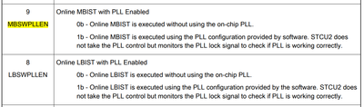

Hi NXP,
1. What are the functions of RUNSW.MBSWPLLEN and RUNSW.LBSWPLLEN in the manual?
2. What is the relationship between RUNSW.MBSWPLLEN and RUNSW.LBSWPLLEN and PLL LOL?
3. How to configure PLL LOL?

Hi @li3
For information on the relationship between RUNSW[LBSWPLLEN] and RUNSW[MBSWPLLEN] with PLL LOL, refer section 54.9.6 of the S32K3xx Reference Manual, Rev. 9, bit 20 (LOCKESW) of the ERR_STAT register.
About PLL LOL configuration, my coworker is already helping you in this thread.

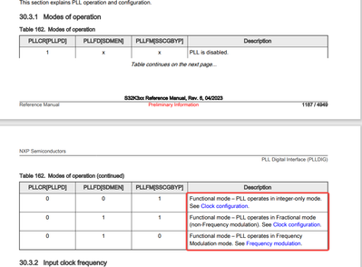

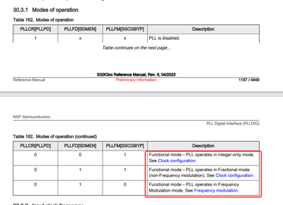

Hi NXP,
1. What are the three PLL clock modes? What's the difference?
2. Are there any differences in the LOL monitoring methods corresponding to these three PLL clock modes?

Hi @li3
1. Depending on the configured PLL operating mode, will be determine the relationship between fVCO and PLL reference frequency. Refer to section 30.3.3 (Clock configuration) of the chip's reference manual.
2. As previously said, a Loss of Lock (LOL) condition occurs when a PLL clock is outside the range of correct operating conditions. Therefore, you should only not violate the maximum system clock frequency or maximum and minimum VCO frequency specification of PLL.
