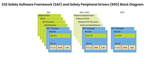

According to the following picture, both SAF and SPD provide Bist and eMcem function, is there any different between SAF and SPD of BIST and eMcem?
SAF is extension of SPD. There is no difference in MIST and eMcem between them from SW point of view as far as I know.

Last question, how about SPD for testing BIST or eMCEM? According to the following picture, both SAF and SPD provide Bist and eMcem function, is there any different between SAF and SPD of BIST and eMcem? Our company need to consider about these solution for ISO26262 or others in the future. Do you have any suggestion? Thanks.

To test the lockstep functionality of K3 series, SAF software package sCheck for RCCU could be referred. RCCU is a hardware module for lockstep check while sCheck could inject error to RCCU using EIM.
