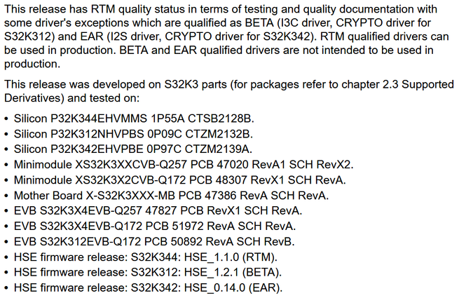

Every RTD release notes specifies compatible HSE_FW revision. Even though it might not cause any issues with other revisions, we cannot guarantee that.
RTD 2.0.0 release notes:
Can you maybe share the project so that we can test it?
You can share it publicly via a support ticket.
