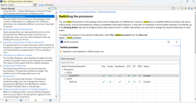

According to S32DS 3.4 help contents in below picture, but I can't find the path "File > Switch processor". Is there anyway to change it?

You can Switch package for Processor in S32CT(S32 Configuration Tool) of S32DS. But unfortunately you cannot switch the processor from S32K344 to S32K312. It is recommended to create a new S32K312 project and refer to the S32CT of the original project.
