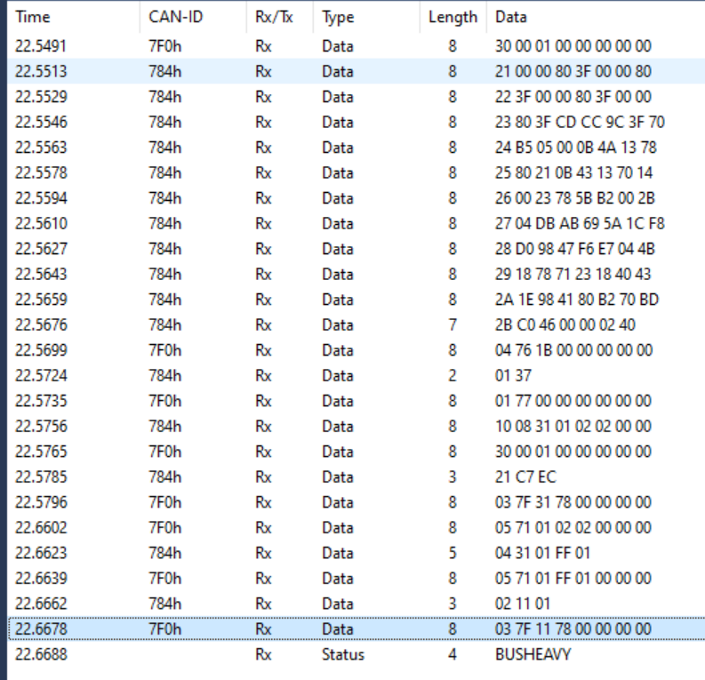

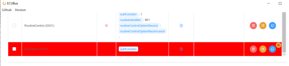

Hi Tomlin:
     Oneself app add APP_bootloader_exchange_info folder,Please see picture1. Oneself app has the same configuration as demo app of S32K116_17_flash.
    But I don't know why there is an error in the last step after upgrading through ECUBus.

According to PEAKCAN message information, app doesn't send "02 51 01 00 00 00 00 00" Why ?

Hi, @xuruiyi
      For PEAK BUSEAVYY: a Busheavy can occur when you want to send a CAN-message and no other CAN-node is able to send a acknowledge frame (wrong baudrate, CAN-bus not connected, no CAN-termination, a CAN-bus system with only one CAN-node etc.) This is from PEAK. https://forum.peak-system.com/viewtopic.php?t=35
      Suggestion you check APP including APP modules and CAN init status. I think you can integrated a module and test, then you can find which module affect the CAN driver.
Tomlin
