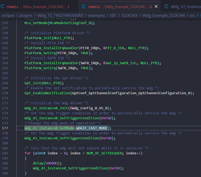

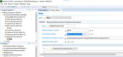

I have a question, in the wdg example(C:\NXP\SW32K3_RTD_4.4_R21-11_3.0.0_P01_HF02\eclipse\plugins\Wdg_TS_T40D34M30I0R0\examples\EBT\S32K3XX\Wdg_Example_S32K344), wdg is configured in slow mode:
In main.c, I can understand that it switches to the fast mode by calling Wdg_43_Instance0_SetMode(WDGIF_FAST_MODE):
While in this case, the customer didn't want to use fast mode, why is Wdg_43_Instance0_SetMode(WDGIF_SLOW_MODE) still needed?
