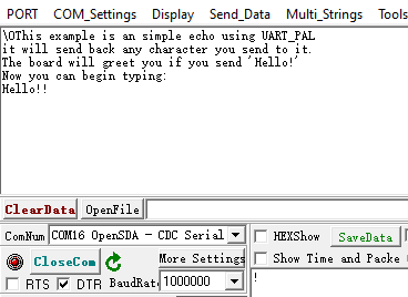

i am getting UART frame error, with communication settings as follows, baud rate 1mbps, databits 8, stopbits 1 and parity none, the data i received i tried to capture on terminal software and i can see data as follows

I see no problem with your settings and i test this demo again with 1M Baud, it works fine on myside.

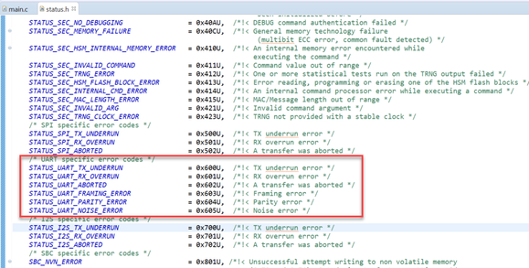

You can confirm the type of error according to the value of status
864 Views
s32k146_ige
i am getting this STATUS_UART_FRAMING_ERROR = 0x603U, error value in status variable
