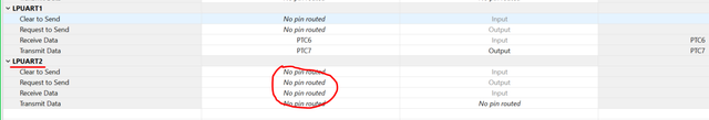

Senlent
Hi@s32k146_ige
We are on a national holiday which ends on 5.3.
You said you are using S32K146(64PIN), this is a very important new information, because in the code you sent me the default is S32K146(100PIN).
If this is the case, the communication must fail, because there are many places in your project that still need to be modified.
1.you need to change your project to s32k146_64
2.Pin configuration for S32K146(64) Lpuart2.
If you are using LPUART2, then the port configuration of your LPUART2 is wrong
The port configuration of the Lpuart2 module of S32K146 (64PIN) is as follows

s32k146_ige
the pin configuration is not an issue, we have been doing this for years. on 64 pin MCU we are using uart1 and c8 and c9 IO pins, we are very much familiar with chipset. this is what i am trying to tell you from day1 that configuration is not an issue. because we get Tx out and we see Rx on scope.
