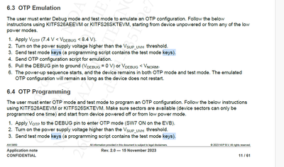

@JozefKozon OTP Emulation mode requires some key access. That is written in AN13850 Section 6.3 OTP Emulation.
Does that mean, I must buy https://www.nxp.com/design/design-center/development-boards-and-designs/analog-toolbox/fs26-safety-s... ? Or is there another way to use OTP Emulation mode?

Hello Hemant,
please check the DBG_MODE bit in the FS_STATES register (latched information) and/or the bit VDBG_VOLT_S in the M_STATUS (real time information) register to confirm, that the FS26 is in Debug mode.

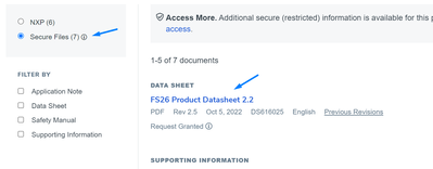

There is a flowchart in the Figure 72. in the FS26 datasheet explaining the steps to enter OTP emulate or program mode. Please check it and confirm, that you have followed the steps.
The FS26 datasheet can be download from the FS26 product page under the secure files.
