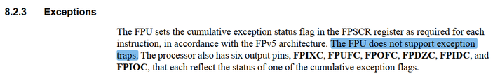

I'm working on S32k358 .I see the exception bit is set in the FPSCR for division by zero exception but i don't see any exception handler  is being triggered on that. I could see the vdiv.f32 instruction.

Hi, It apparently should not trigger an exception, it is rather expected to test status register after operation.

Unfortunately I don't have example code to share. I is just needed to test FPSCR register after operation.
