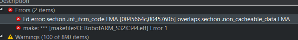

Hello @lukaszadrapa again !
I've tested what you've suggested into my code and the error that I'm getting is this:
Have you ever anticipated this ?
I'm uploading the linker file and my startup. I've confirmed that there are no diffs with the one that you've used with winmerge software.
Kind regards,
kyf
7,208 Views
lukaszadrapa
Hi @kyf ,
I can't see a reason for this. Do you have whole project which could be shared with me to replicate it?

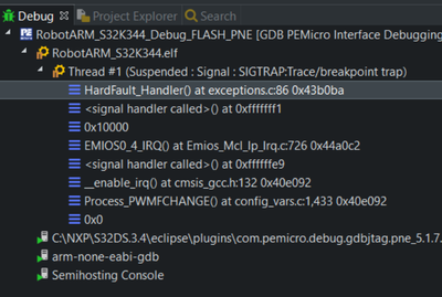

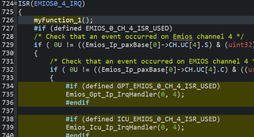

Hello @lukaszadrapa . Thank you for your quick response to my question.
I've tried your suggestion,
And I've declared my function with the attribute directive.
I've seen in the .map file that my functions are stored in the ITCM memory section.
But when I run my program I get an hard fault error. And the message that I get from the debugger is this:
My ISR callback is the first function running inside EMIOS0_4_IRQ() ISR.
I've checked the memory that my function supposed to be stored and there is nothing there. The whole ITCM memory section is set to 0 (as it is after the startup code initialization).
Do I have to do anything else in order for my code to run inside the ITCM?
Kind regards,
kyf
7,336 Views
lukaszadrapa
Aah, OK, sorry, that's solution for flash, not for RAM / ITCM. When using this way, the code is compiled for these addresses, but it's not copied to the RAM. It's either necessary to copy the code manually or to force startup code via linker file to do that automatically - which is better option, of course. I don't know this from top of my head, let me check this later today or tomorrow.

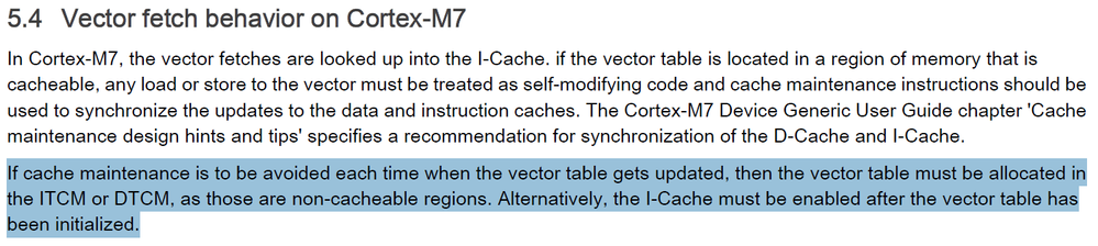

I need also to move my vector table to ITCM memory in order to avoid cache maintainance as mentioned in the chapter 5.4 at S32K344 RM.
Has this to be done also at the startup code ? If yes how can I do this? Can you please provide me any assistance with this (documentation or any resource regarding this) ?

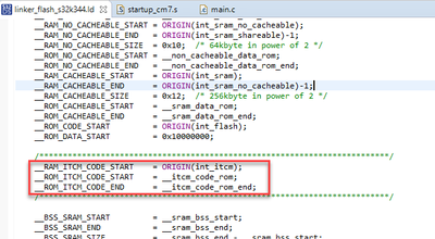

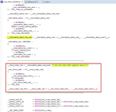

What is necessary to do:
Define section like this in the linker file. You can use .shareable_data as a template for itcm. "AT" directive is important.
Second step - define the RAM and ROM addresses which will be used for copy-down:
Next step - update the init_table. Add one more entry like this and increase the entries count:

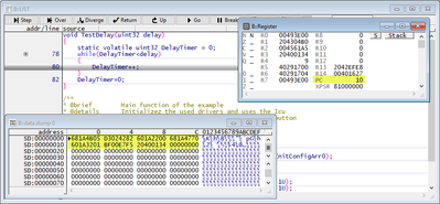

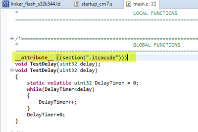

Then use the attribute for some function:
And now it works:
It will the same for interrupt vector table. By default, it's in normal RAM. Just remove it from the RAM and add it to the ITCM.
