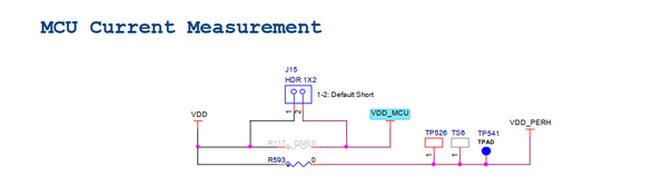

CAN, FTM, ADC, IRQ, etc. used in this way have been disabled, but 40mA comes out.
We used a digital multimeter to measure the power supply by connecting + and -. Is this the right method? The current goes nowhere

If you have the S32K14W-Q064 Evaluation Board, there is J16 for current measurements.
You need to measure the just MCU consumption, not the consuption of other devices on the board.
Also, make sure you don't drive any load with the MCU outputs.
The outputs retain their states in VLPS set in the RUN mode.
