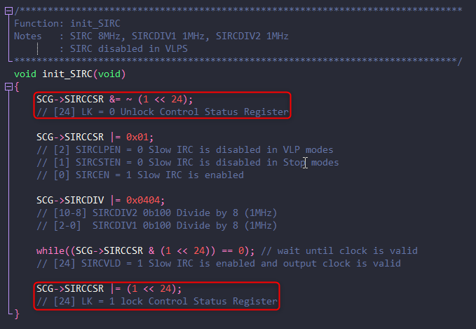

Hi Daniel,
I found an issue when I follow your example:
You set SCG->SIRCCSR[LK] = 0 at position 24, but when I check in datasheet LK is in 23.
Should I use bit 23 or 24 right here?
Hi Nhuan,
Thank you, it has been updated.
