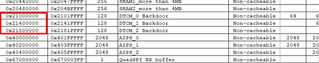

Hello NXP team,
I want to use DTCM as system ram, I found below configurations in the offical training material:
but it doesn't work.
I'd like to know what the right configuration is?

Number of threads 1 (Scheduler not yet running)
MemManage: The processor attempted a load or store at a location that does not permit the operation.
Possible MemManage fault location: 0x20000124.
HardFault: A fault has been escalated to a hard fault.
1,641 次查看
davidtosenovjan
It should works as it is correct sequence.
DTCM must be also initialized for ECC by 64-bit writes either by core or DMA.
If you use it as system RAM. i.e. you are accessing by different master than the core this TCM is related to, you will have to use backdoor access address range.
