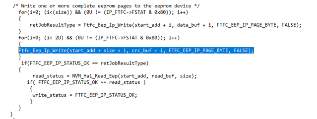

if(0U != (IP_FTFC->FSTAT & 0x80))
/* Write one or more complete eeprom pages to the eeprom device */
for(i=0; (i<(size)) && ( 0U != (IP_FTFC->FSTAT & 0x80)); i++)
retJobResultType = Ftfc_Eep_Ip_Write(start_add + i, data_buf + i, FTFC_EEP_IP_PAGE_BYTE, FALSE);
if(FTFC_EEP_IP_STATUS_OK == retJobResultType)
for(i=0; (i< 2U) && ( 0U != (IP_FTFC->FSTAT & 0x80)); i++)
Ftfc_Eep_Ip_Write(start_add + size + i, crc_buf + i, FTFC_EEP_IP_PAGE_BYTE, FALSE);
read_status = NVM_Hal_Read_Eep(start_add, read_buf, size);
if( FTFC_EEP_IP_STATUS_OK == read_status )
write_status = FTFC_EEP_IP_STATUS_OK;
else{
write_status = 0x03;
return (write_status);

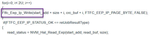

It is rather difficult to navigate in both the description and the code.
Both the APIs Ftfc_Eep_Ip_Read and Ftfc_Eep_Ip_Write check that CCIF flag.
And return Ftfc_Eep_Ip_StatusType Status = FTFC_EEP_IP_STATUS_FAILED; if it is not set.
Whereas you check the flag before you call the APIs in these for loops:
for(i=0; (i<(size)) && (0U != (IP_FTFC->FSTAT & 0x80)); i++)
Which is not correct in my opinion.
Then, you don't read the status of this function:
So, you keep writting and reading it based on a wrong status, I think.
I would keep the condition before Power_Down_Sequence().
I don't see the point in reading the FCCOBn registers unless it is after the Query command.
And in this case, the API returns the correct status.
Does it return a BO error?

Hello Daniel,
Previously we were doing like this but by this it was stuck  in Ftfc_Eep_Ip_WaitCcifTimeout function inside while loop in Ftfc_Eep_Ip.c file.
uint8 NVM_Hal_Write_Eep(uint32 start_add, uint8 *data_buf, uint16 size)
    uint16 crc=0xFFFF;
    uint8 write_status = 0x01,read_status = 0x01, read_buf[size], crc_buf[2]={0};
    /* calculate crc */
     crc=I2C_HAL_Calculate_CRC16_ccitt(data_buf, (size));
     /* At the end of data buffer add 2 bytes of calculated CRC */
     crc_buf[0] = (uint8)((crc >> 8) & 0xFF);
     crc_buf[1] = (uint8)crc;
        for(i=0; i<(size); i++)
        for(i=0; i< 2U; i++)

So after that we added the CCIF checking for read, write and erase.
