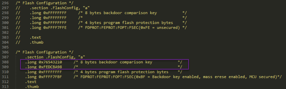

I believe that it is explained in the example.
The backdoor key is defined by the user in the startup_S32K144.S file.
At 0x400 in the S32K1xx_flash.ld linker file.
The Backdoor Key Verify FTFC command (0x45) can be used only if the flash configuration field has the key defined.
The command unlocks the MCU so that the debugger can access the memory/registers of the MCU.
If the key is not defined and the MCU is locked, the debugger can only mass erase the MCU.

  how can I know the backdoor key?and if my device S32K148 demo board executed erase all block command the
device will be secured, openSDA can't connect with Device  and D1 led keep light, then how can i resove this problem?
if execute backdoor command, but I don't konw the backdoor key.  onthe other hand if i know the backdoor key how can i execute this backdoor command in the deviec?(Debug can't connect)
