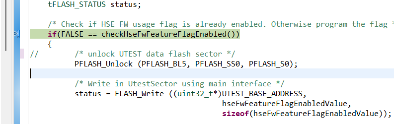

Sanjana_k
#I am working on the S32K3X4EVB-T172 board and trying to install the HSE firmware
The HSE firmware flashing is successful, but my application always stops at:
if (FALSE == checkHseFwFeatureFlagEnabled())
/* Stuck here */
So HSE FW initialization does not proceed.
I checked the UTEST region (0x1B000080), and I am getting the value 0XFFFFFFFF
please review our project and image and help us with this problem .
Thank u
