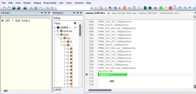

Shruthi_C
Hi Petr,
Im unable to use  INT_SYS_InstallHandler(FTM0_Ch0_Ch1_IRQn, PWM_InputCapture_IRQHandler, NULL);  function  as its taking default handler and not taking this handler FTM0_Ch0_Ch1_IRQn

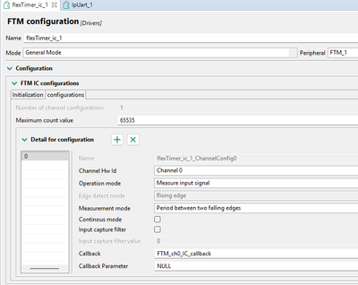

My configurations are
/* Global configuration of flexTimer_ic_1 InitConfig */
ftm_user_config_t flexTimer_ic_1_InitConfig =
        true,    /* Software trigger state */
        false,  /* Hardware trigger 1 state */
        false,  /* Hardware trigger 2 state */
        false,  /* Hardware trigger 3 state */
        false, /* Max loading point state */
        false, /* Min loading point state */
        FTM_SYSTEM_CLOCK, /* Update mode for INVCTRL register */
        FTM_SYSTEM_CLOCK, /* Update mode for SWOCTRL register */
        FTM_SYSTEM_CLOCK, /* Update mode for OUTMASK register */
        FTM_SYSTEM_CLOCK, /* Update mode for CNTIN register */
        false, /* Automatic clear of the trigger */
        FTM_UPDATE_NOW, /* Synchronization point */
        FTM_MODE_INPUT_CAPTURE, /* Mode of operation for FTM */
        FTM_CLOCK_DIVID_BY_1, /* FTM clock prescaler */
        FTM_CLOCK_SOURCE_SYSTEMCLK,   /* FTM clock source */
        FTM_BDM_MODE_11, /* FTM debug mode */
        false,    /* Interrupt state */
        false     /* Initialization trigger */
/* Input capture configuration for flexTimer_ic_1 */
ftm_input_param_t flexTimer_ic_1_InputCaptureConfig =
    1U, /* Number of channel configurations */
    65535U, /* Maximum count value */
    flexTimer_ic_1_InputCaptureChannelConfig /* Channels configuration*/
/* Channels configuration structure for flexTimer_ic_1 input capture */
ftm_input_ch_param_t flexTimer_ic_1_InputCaptureChannelConfig[1] =
        0U, /* Channel id */
        FTM_SIGNAL_MEASUREMENT, /* Input capture operation mode */
        FTM_RISING_EDGE, /* Edge alignment mode */
        FTM_FALLING_EDGE_PERIOD_MEASUREMENT, /* Signal measurement operation type */
        0U, /* Filter value */
        false, /* Filter state (enabled/disabled) */
        true, /* Continuous measurement state */
        NULL, /* Vector of callbacks  parameters for channels events */
        NULL /* Vector of callbacks for channels events */
タグ(1)

PetrS
if you need to install handler again you should have
extern void FTM0_Ch0_Ch1_IRQHandler(void);
INT_SYS_InstallHandler(FTM0_Ch0_Ch1_IRQn, FTM0_Ch0_Ch1_IRQHandler, NULL);
BR, Petr
5,156件の閲覧回数
Shruthi_C
Yes I do have that function defined, but after that the function call goes to infinite loop, and it will run further
The whole system will not work,
Shruthi C
タグ(1)

PetrS
driver is using interrupt for capture event, only not shown in example directly.
I modified FTM IC setting to use one shot mode and add Callback, which is called from driver interrupt.
See attached for modified main.c of ftm_signal_measurement_s32k146 demo.
BR, Petr
