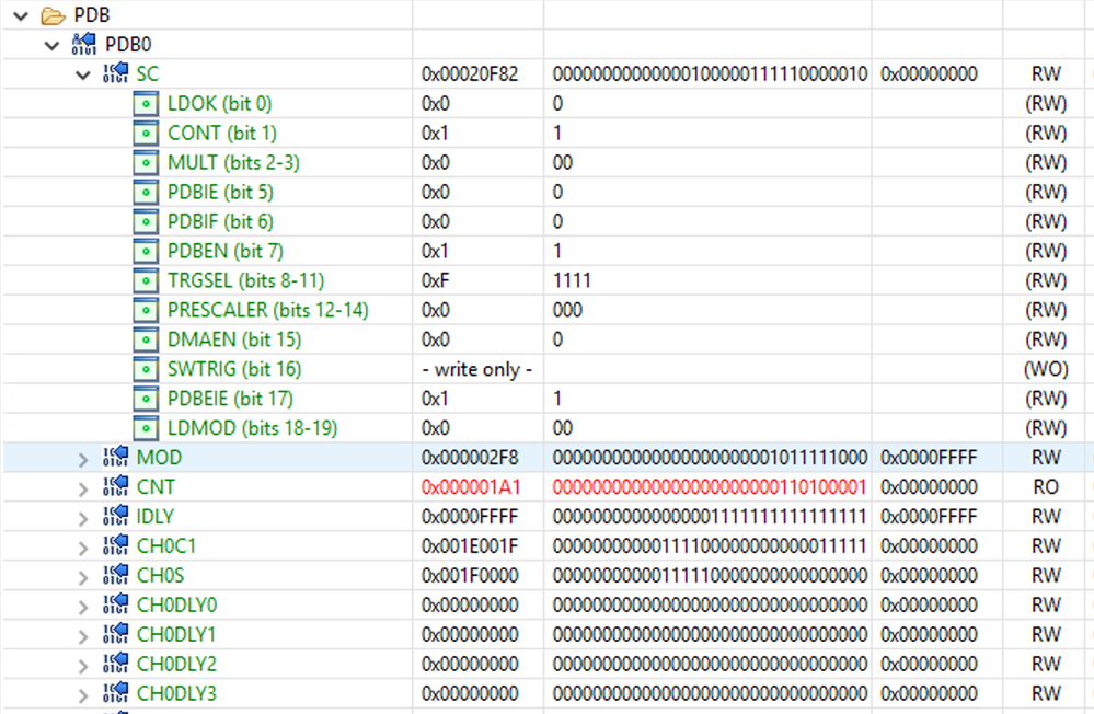

I try to setup PDB0-ADC0 for continious sampling. Below I have attached the register setup. PDB0 and ADC are clocked with 50 MHz. I am using a S32k144.
When I init the registers I see 1 sample only. I observe that the PDB counter count up until MOD and restarts at 0.
My expectation is that at restart this triggers new sampling. Also CH0S does not show any error.
What do I miss to do? Anything special to start continious sampling or do I setup the registers not correct?
Thanks in advance for your help or hint.
Edgar

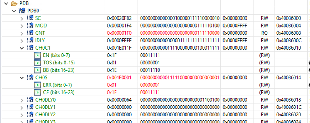

I tried this also. If I set the TOS bit and a delay eg 100 then the CF ist set after the COunter CNT reaches the delay
This screen below. I have tried several settings - with and w/o sw trigger. Also no BB but TOS Bits set  and delay.
It is not clear to me how do I set properly continous mode. Setting TOS and delay register is of course also fin.
Basically what I need is a setup of the registers to sample 5 ADC channels continously at a maximum of 10 usec per loop.
Any idea or example how to set this up?
Maybe I shall mention that the ADC values not read after each conversion ie COCO is still set when the next conversion starts.
While debugging I guess that the CHOS-ERR are set for the channels if COCO is still set ie ADC value not read.
Is that the issue?
