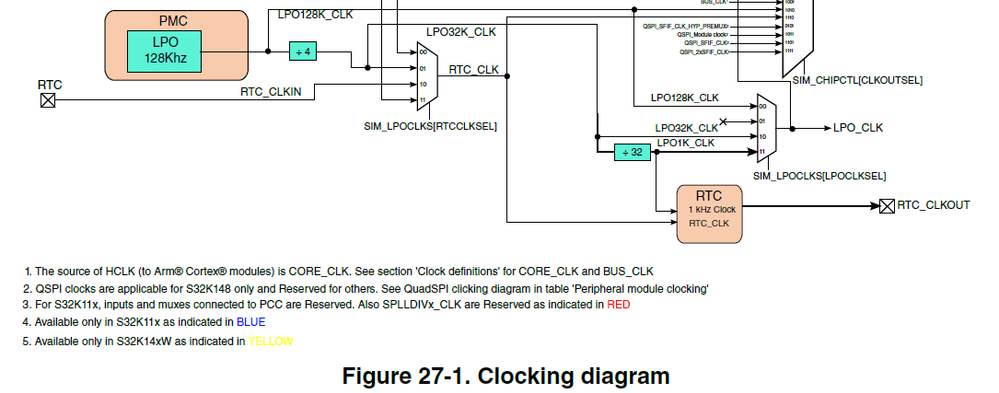

I am able to enter in the VLPS mode but neither the RTC interrupt nor the port interrupt is able to wake up the controller.
For RTC, I am using LPO_1KHz clock. Is this correct configuration?
4,858 Views
danielmartynek
Hello pranavshinde,
The SDK example (power_mode_switch_s32k144) uses a port interrupt as a wake up source.
Does it mean the example does not work?
Yes, LPO_1kHz is functional in VLPS and it can be used for RTC.
