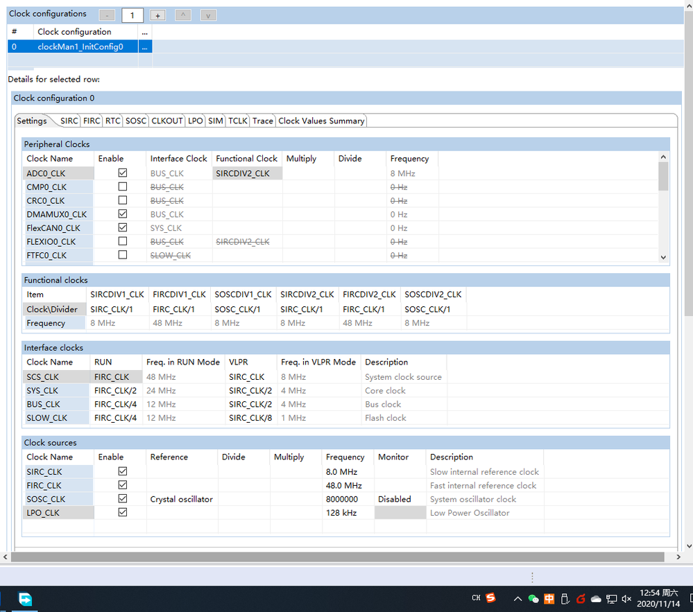

How do I configure SPLL CLK?

jinsheng20

Hi jinsheng20,
The Phase-locked loop (PLL) is not available for the S32K11x product series. That is why you cannot configure it.
